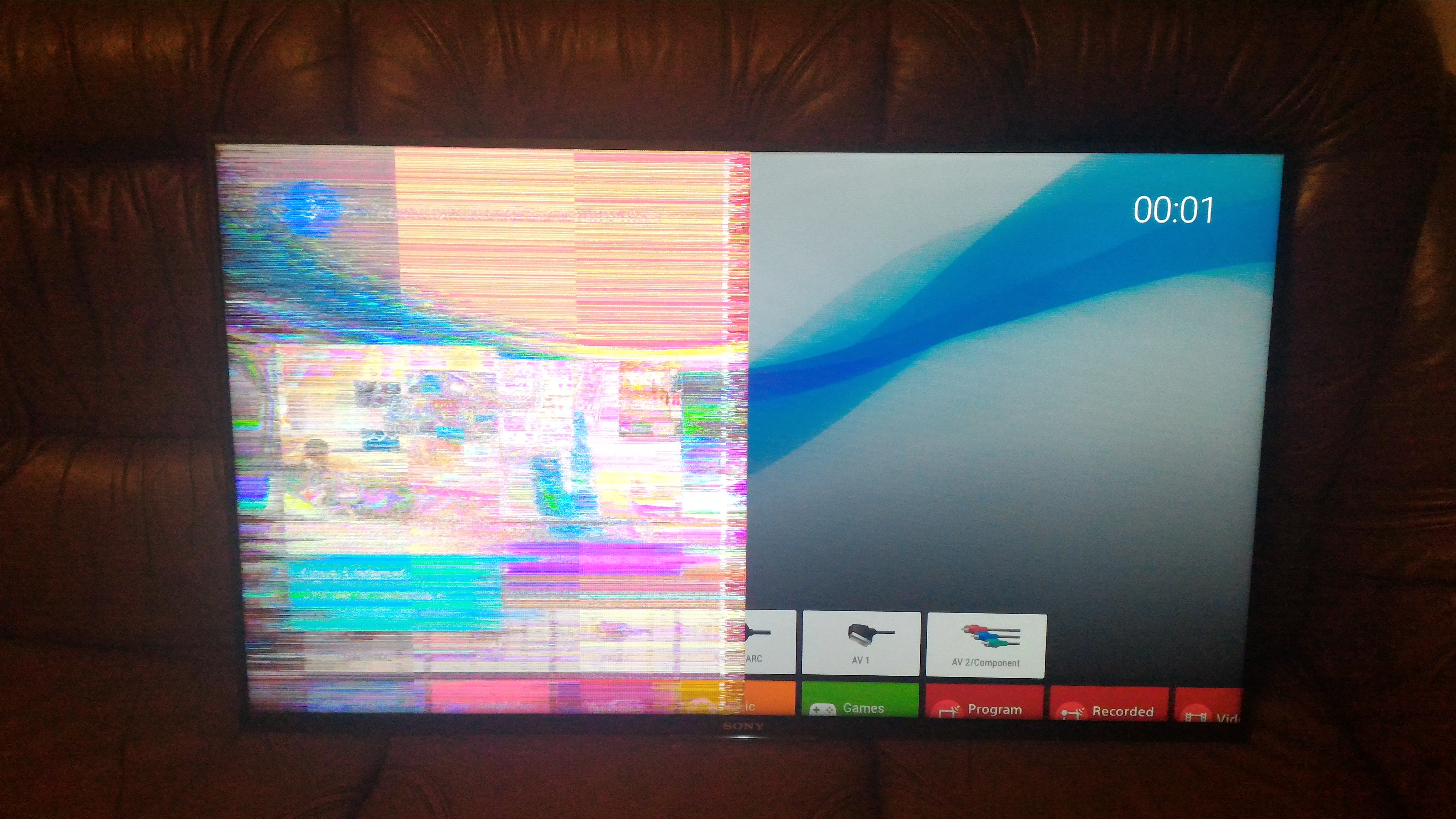

Exactly a year ago, i've bought a Sony KDL-43W808c Android TV.
The experience, has been great, until today. Today the TV broke down as seen in this picture:
I've looked around, and couldn't find any complain with the same problem with these models. But there's tons of other brands, and Sony other models, with the same faults.
Of course i've called the support, since I have 2 years of warranty, but my believe in the brand is crushed...
I have a Bravia LCD from 2007 and its running great, serving as spare right now. How could these new models break after 1 year?
If i'm right, and the fault is in the panel, there's probably a chance that, if repaired or even swapped for a new one, it might happen again, that's a horrible thing... waiting for a device to break down...
Anyone had any kind of problems like this?
Best regards,
Ricardo [Edited to remove surname for privacy]
Ricardo
I had a Toshiba laptop that did this. Toshiba fixed it under warranty, and then out of warranty, it did it again.
But it was a known fault with these.
Regarding your set, like you say, there are lots of reports of other makes, and other series of Sony models, doing this, so it is a thing that panels do.
But it does not seem to be a reported generic fault with this series, so you should not, perhaps, worry unduly about a recurrence, after you get it fixed under warranty,
While it probably is a hardware fault, though, it cannot hurt to try a few resets; the one where you keep your finger on the On/Standby button for ten seconds, then the one where you pull the power to the set (don't just switch it off) for two minutes, and finally the full Factory Reset, if you can see enough on the screen to find it.
Until either one of them works, or all your options are exhausted, and the set has to go back.
I buy everything I can from Richer Sounds, in the UK, to get the peace of mind of their five year warranty, which is most inexpensive, or even free sometimes.
Thanks for the reply royabrown.
I triend reseting everything, even knowing that it is an hardware fault. I work with costumer support, reseting things and testing is almost a way of life
I had the option for 5 year warranty, it was not very expensive (40e) but I thought, "this is a Sony, I own Lot's of Sony produtcs, they dont break berofore the 5 year mark". My KLV-S32A10E is almost 10 years old and works like a charm. Hell, even my playstation 1 is still working and we all know that those lasers were garbage 😐
