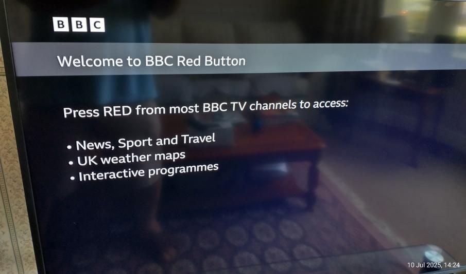

New Bravia Red Button home page
New Bravia when pressed Red

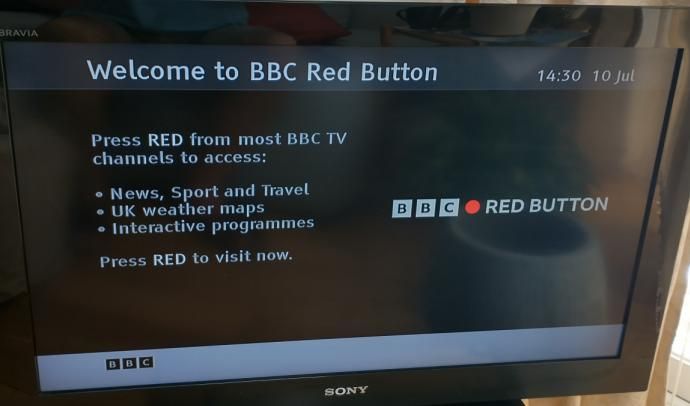

Old Bravia Red Button home page

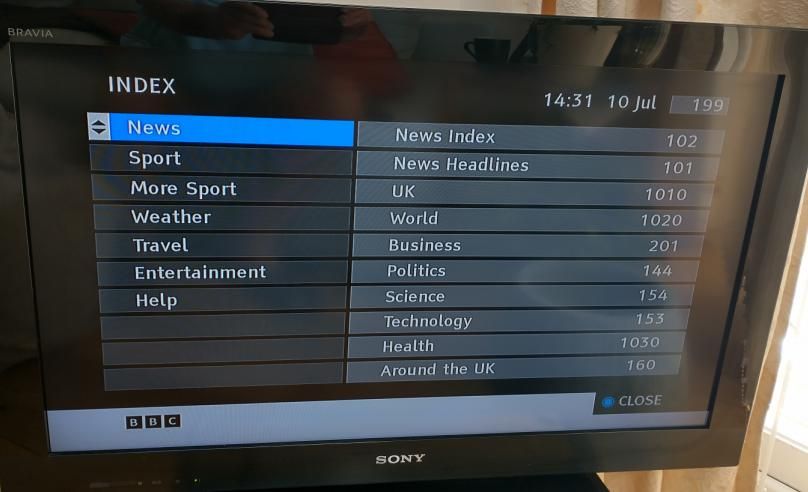

Old Bravia Red Button index page

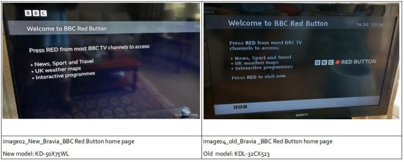

Comparison
BBC Red Button issue:
As you can see the sentence 'Press RED to visit now.' which should activate [and bring up the Red Button Index page] when pressed the red button on the remote control handset is missing from the new Bravia.
Any thoughts/help/advice, please?

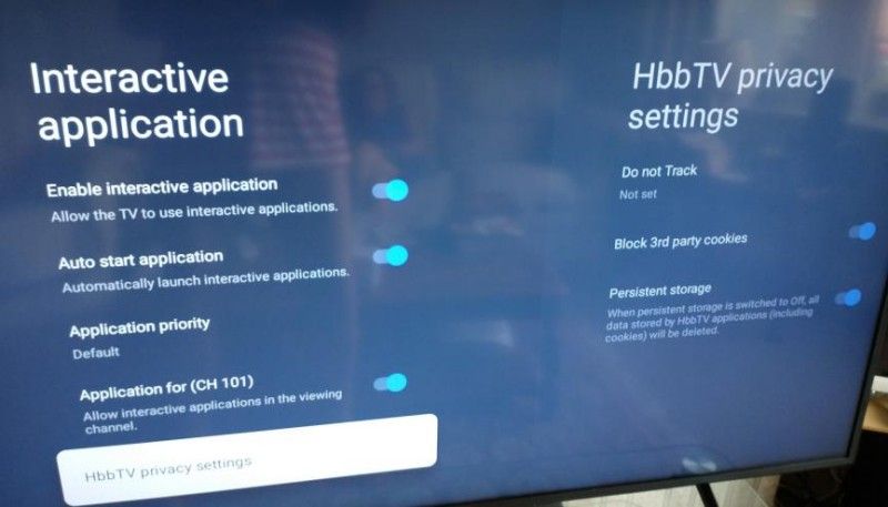

I do not have any applicable option under the HbbTV settings to try to set it so that I would get the services.
Does this mean that this new TV is not supporting HbbTV?
I have attached another image showing the HbbTV settings on this new set.Showing options under HbbTV settings

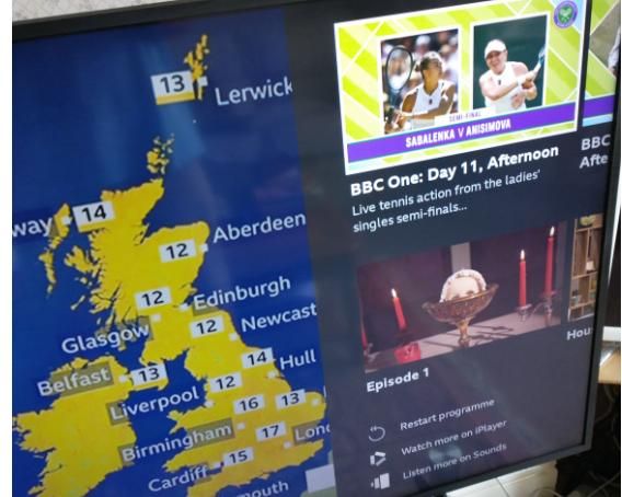

Your TV like my 2022 XR42A90K can only use the Connected Red Button, which connects via internet and displays options for the iPlayer. My TV like yours does not have the MHEG decoder necessary to provide the text services you are used to.

Your TV is using HbbTV as you are able to get the Connected Red Button service which gives you options for iPlayer. That is why it is showing under the Settings menus.

Now how do you explain the content of the new Red Button home page on Ch 250?
I re-post the image for you.
According to this page, I should be able to get the services listed by pressing the red button from 'most' BBC channels.
Now, let's say I am on one of these channels and have pressed the red button on the handset, how do I get those services?

It is about MHEG as the BBC quote points out, without an MHEG decoder you will not get the text service, only the Connected Red Button service.
This is just a general broadcast page it does not know if you are using a TV that has a MHEG decoder or not.
You can’t your TV does not have a MHEG decoder in order to display these services.
When your TV is connected via WiFi or Ethernet the TV will default to connect via the Red Button to the Connected Red Button service> the iPlayer services.

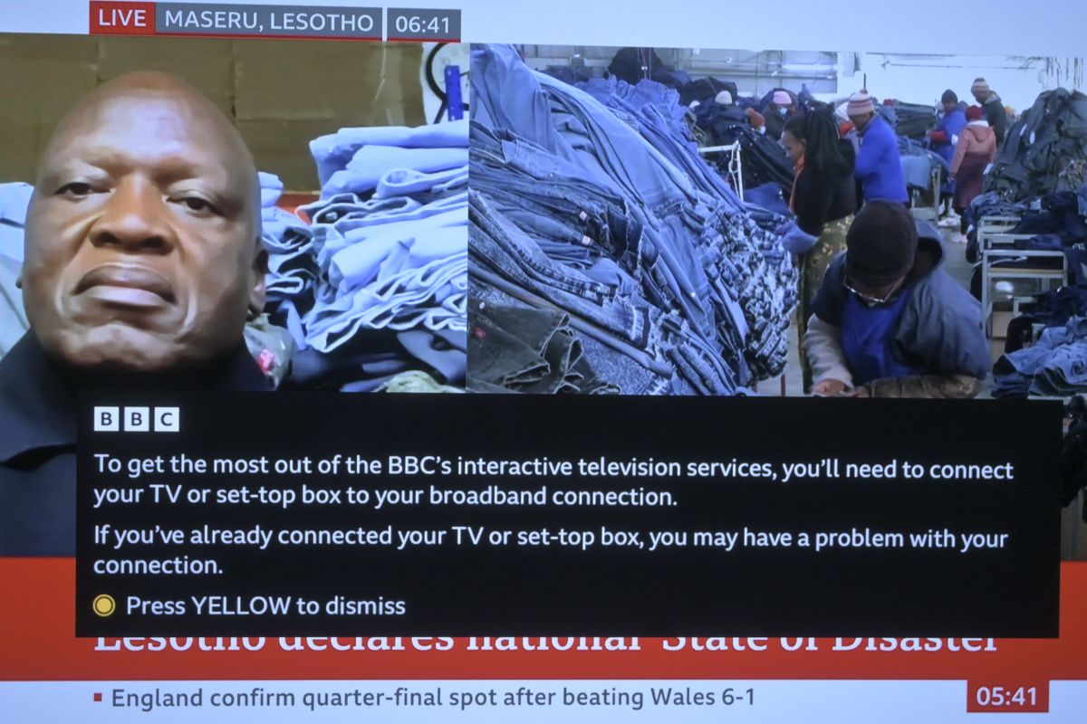

If you disconnect your internet connection to your TV and then press the Red Button you will get a warning, as below.
If on the other hand you you have an older TV that does have the MHEG decoder included and you are disconnected from the internet pressing the Red Button will connect you to the text service.
My older Sony TVs 2012 and 2019 and my PVR a Humax 5000T 2018 can all receive the text service,
My newer 2022 Sony TV and Humax Aura 2021 do not.
