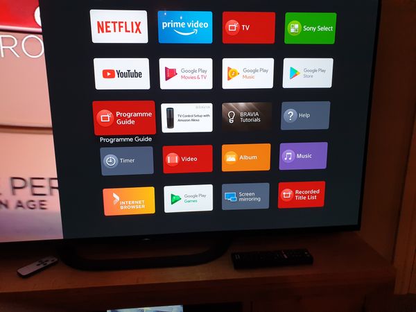

Hawkeyehawk
hi rooobb - I found the video APP, I've sent a couple of pictures of the screen shots showing the APP and what you get when you click on it. If you feel that formatting the HDD in NTFS will help I go ahead, am I right in saying that if HDD is recognized on the TV and are able to register the drive it will get formatted so it will work on the TV.
