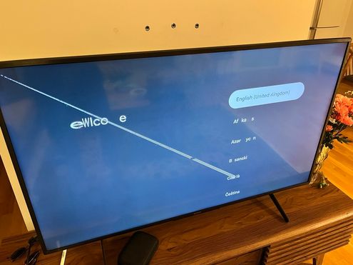

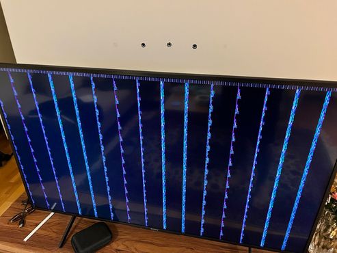

Hi all,
Hope everything is fine with you, My Android TV (kd-50x81j), started being weird. The UI became so slow, and every time I tried to select an app (like YouTube), UI got restarted. I did a factory reset, and after that I only see vertical lines on the TV as you can see in the photos.

In addition, when the TV starts and SONY logo appears, it seems perfect. After that, Google's logo suppose to appear on the screen, but instead I get some blue, green and red dots on the screen! That's why I think there is not issue with LCD panel. Some thing is wrong with GPU or something like that :(.

I guess when the TV starts up with the black screen and white Sony logo
it is not using the full graphics capability of the TV and only when it switches
to full graphics mode it reveals the problem.
So you may be correct the graphics board has failed.
