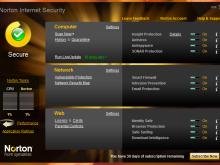

3. Go to the Norton main screen and try disabling all the fancy features like 'SONAR Protection' and 'Insight Protection' and see what happens.
