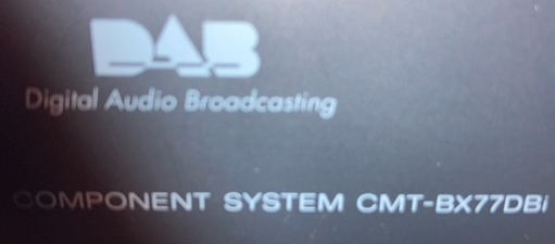

Thanks very much for trying to help... I just looked at the unit again, I had taken the Model Number off the front ... when I look at the back it shows...
Back Plate
Front of Unit
I can find reference to this when I do a Google search ... but nothing that helps with the issue I have.
