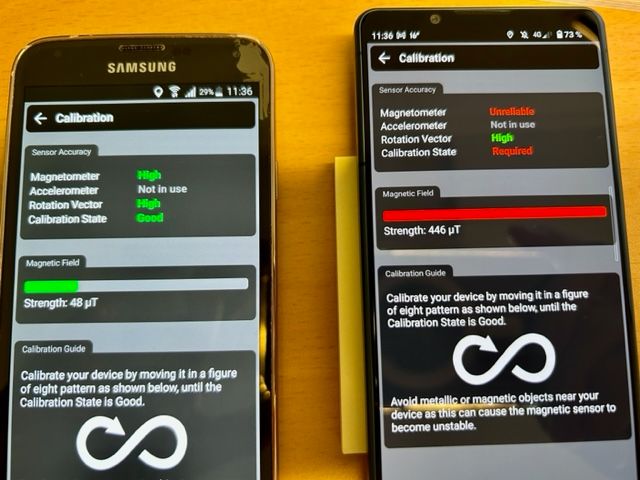

Ok, already done this. Wouldn't have written here otherwise and from what I've read (and experienced) it's not easy to calibrate the compass from "low" to at least "medium" accuracy within Google maps with the 5 IV. Also, the "GPS Test" suggests a calibration for the compass and marks it as "Unreliable". Only on this phone(!). Magnetic field present >400uT - again only for this phone. If you Google it I'm not alone...no case attached either. Phones in the same room (or place outside) manages this perfectly.
If someone with a 5 IV could show me a screenshot of a working calibrated compass within Google maps I would happily accept that this could be a sample variation and not a wide spread issue.
Also, to further illustrate the issue with the 5 IV compass compared to an old Samsung Galaxy S5(!) with a picture;
(Both recently calibrated)

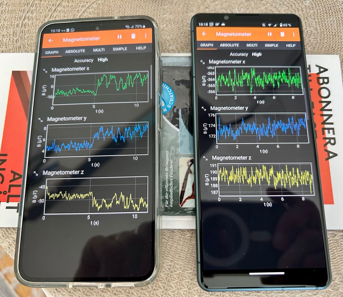

Below I've now provided new screenshots of this issue from another location compared to another phone (the SGS23) and the 5 IV to the right,
I would appreciate these (Phyphox app) screenshots from another users with the 5 IV
