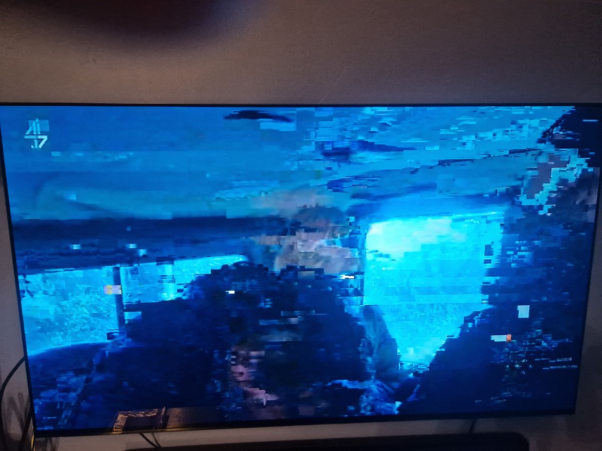

We just bought a Sony Bravia 55" 4K TV. We are mostly satisfied with its performance, but have concerns with its behaviour when viewing via digital aerial in the 'TV' app.
Most of the time we get really good reception and good  image and sound,  even on HD channels. We assume, therefore, that there is no problem with signal strength. Then, for no apparent reason, mostly when changing channel or just after switching on the TV, the picture breaks up and sound stutters in SD and HD. Waiting a few minutes, changing channel or restarting the TV fixes the problem. This is obviously unsatisfactory. We want a TV that works like a regular TV using a digital aerial signal when we want it to.
Any ideas of what might be causing this or suggestions for fixing it?20240922_232557.jpg

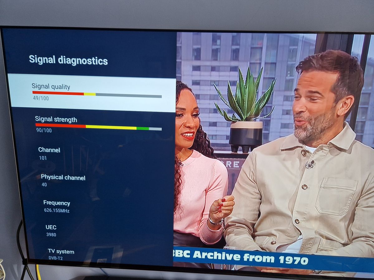

Thanks for your reply. I can answer  some of your questions straight away. Firstly, I know that the signal is not ideal. I am working to improve it, but I was puzzled why I should be getting a good HD reception whilst getting break up in SD. Some of your points might be answering my question.
The issue is primarily on a particular spur from the roof aerial. The coax is high quality. It runs into the house then via a powered booster, where it splits into two - one branch to the Sony 4K TV and another into a Humax Aura 4K TV box in a different room serving a Samsung TV. The reason I have a powered booster is because up until a few days ago the spur split at a passive junction and I was having similar problems.
The HDMI running from a PC adjacent to the Sony TV is a heavily shielded gold type, but is close to the aerial coax, but not touching,  because their sockets are close on the TV.
Generally on signal tests throughout the house and on the spur in question signal strength is up to 90% and quality only 20%!  Today, following your instructions, signal strength 90/100%.  No reading for quality. The tool initially  suggested the channel was not available even though it was playing, but then after 5 minutes kicked in with a quality reading of 47%. (see image)
Our transmitter is Sutton Coldfield (33km) . There are known variable issues in the area, i.e. a nearby tower block has mobile phone masts and microwave drums on it.
I will repeat the diagnostic on other channels in different MUXs and report back later. 20240924_093502.jpg

So, aerial technicians have been in and found that the key booster junction box had pretty much failed and the 4G filter needed upgrading to include the 5G interference coming from a nearby tower block. All have been replaced and signals checked throughout the house. We now get 100% quality and between 60%-80% signal strength. That's ideal.
Whatever was causing the Sony TV to be inconsistent has now no longer an issue. I guess it was trying to make the best of a poor situation. A rescan of channels has filled in any gaps that shouldn't be there and reception on SD and HD excellent.
