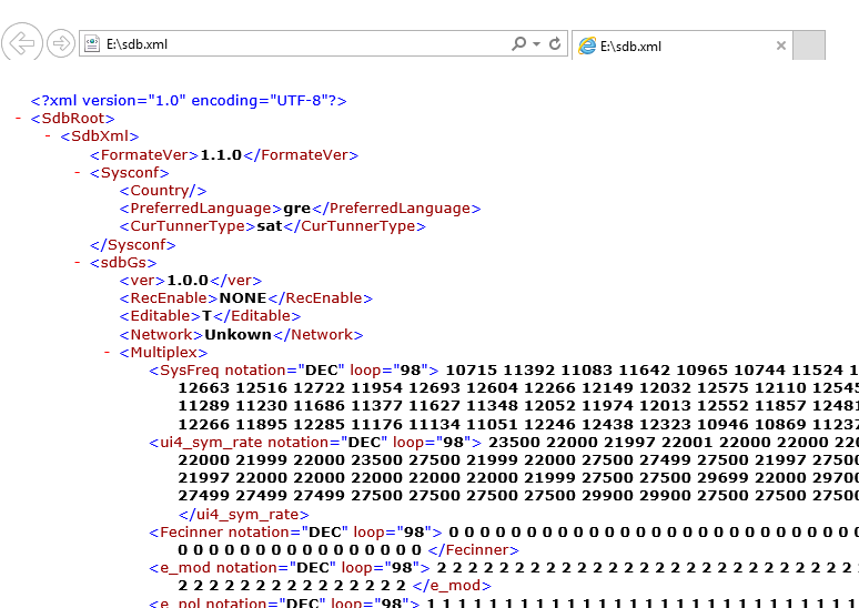

Hi @RussellRay
This is how it looks :
I don't know if @svansvan SDBEditor can be used to delete region and save this. You can try his software but if it works then you must not use SonyEditor or SetEditSony to edit again the same file.
My only issue using a non region sdb.xml back to TV, is that I must re-adjust my region's local time.
Also the deleted channel reappear issue is not solved.

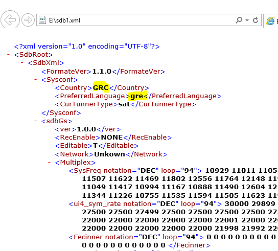

Hi, you can change anything
If change in menu->View->Technical - you can change more than all
If delete channel - channel reappear
If channel mark as deleted - everything will be fine
and channel can labeled as hidden.
