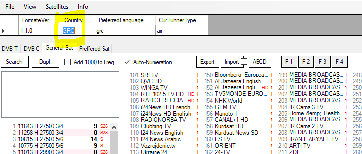

The problem is that the old sdb.xml keeps information about your region - country.
When importing this back to TV then the Country information goes back to your TV.
Unfortunately I had to scan again, export to USB and make a new list.
Did anybody try what happens when manually emptying the <Country> tag? I might try this because I don't really want to factory reset at the moment. There must be another way to change country...

You know Satellite channels re-sorting and re-appearing themselves was my main issue since the beggining, December 2015. I never found a real solution to my problem and Sony could not fix. I don't know why. There were workarounds though. I have stopped working on this and leave channels "as is". At least they do not re-arrange themselves automatically.
I have not tried editing manually sdb.xml. Svansvan says you can with SDBEditor. There is no other way anymore since 123 Initial setup is missing from Settings.
Cheers
I will try that yes. One could still use a text editor too though as you already provided an example on how this should look like:
<Country>ABC</Country>
to
<Country/>
Factory reset is the other option which I don't want to do. Too bad they removed the 1-2-3...

I think that this is not necessary to edit the text.
You just click inside Country box, then delete GRC or DE or whatever and then Save file. If no success when opening again then re-delete click on another box e.g. preferred language and save again. Second try was OK for me.
Yes I know a factory reset is a solution but none of us wants this every time a problem appears

TV issues the following error:
"Cannot import for the following reasons:
Stored programme list in the connected USB device is invalid.
Country of the stored programme list differs to the one in the TV."
So the only thing one can do with Marshmallow is to perform a factory reset. So I have to reiterate:
What one can easily conclude is that channel management on Sony is massively screwed up and lacks a proper documentation.

Be aware that doing so there will be a very very slow channel search and also your regional settings-time will also be wrong and might need often correct setting. See this:
https://community.sony.gr/t5/android-tv/kdl-50w809c-satellite-channels-re-sorting-themselves/td-p/20...
By the way, did you try changing time region settings? This might allow importing your file.

One can easily imagine that screwing with the region would imply other issues. I am not doing that and I also don't recommend it to others. Sony needs to fix that. But they probably won't. How hard can it be not to force the regional channel sorting all the time?
