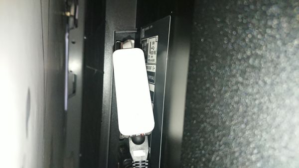

Hi great news fixed the Internet speed (Ethernet) I was only getting 84mbps. So I took the gamble and went and got a tp-link USB 3.0 Gigabit adapter. Fingers crossed, I put in the USB 3.0 slot on TV with ethernet cable fitted and.......... 😊 OMG it worked, I'm now running over 130mbps through ethernet... Problem solved. 😊

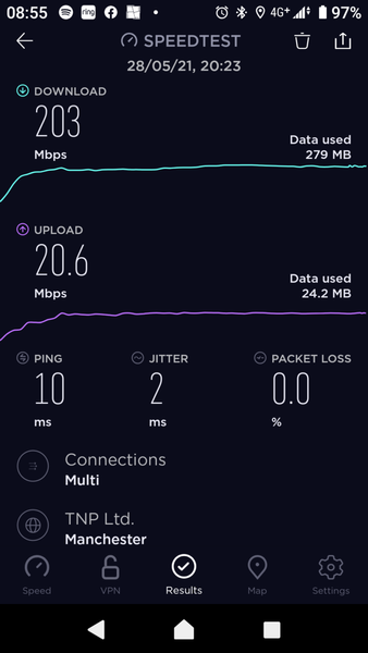

130mbps isn't a hell of a lot though. How fast is your internet supposed to be? You could also try analiti app which can be installed via Play Store.
We only have upto 200mbps on virgin media in the 🇬🇧 UK, but what I'm getting is the same as if I was using WiFi. So I'm happy as ethernet is more stable. Loads faster now. At least it worked and people now know what they can do as a alternative... 😊
