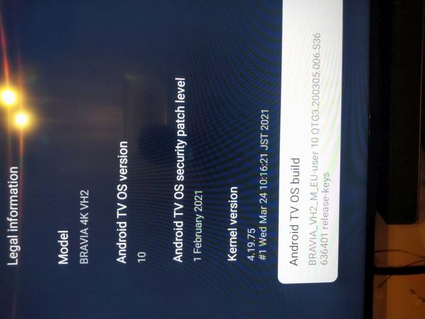

ATV2 based TVs just lack a respective driver.
D-Law81
Member
This may seem or be a waste of time but I saw a video when someone used a link like I did but the had to when all connected have the TV restart (not reset) and it then worked for them..
This is what my TV is running. 😊
 it may not work but just thought I may say what I saw, what someone did on YouTube. OK.
Pentium_Gladio
Specialist
Hi,
To check the exact software version you can find it by pressing the help button. You can find it on the bottom left or you can select system information to find it.
