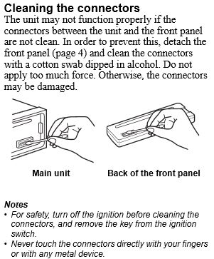

The first thing that springs to mind is that the connectors may need to be cleaned on both the detachable panel & the main unit..
If that doesn't resolve the problem then it might be worth asking a reputable specialist radio repairer/installer in your to take a look..

Hi
Sorry for the delay in the reply. We tried cleaning the connectors a week or so ago and it didn't help the problem, the head unit was still flashing as if working but when pressing buttons nothing was happening. However after trying to get the stereo out of the vehicle entirely (and failing as we had the wrong radio keys), the radio spat out the CD which was in the unit. When I put the CD back in the radio it started up as usual.. and all of the buttons on the radio unit suddenly worked again! So at the present time it is working and has been for the the past week.
